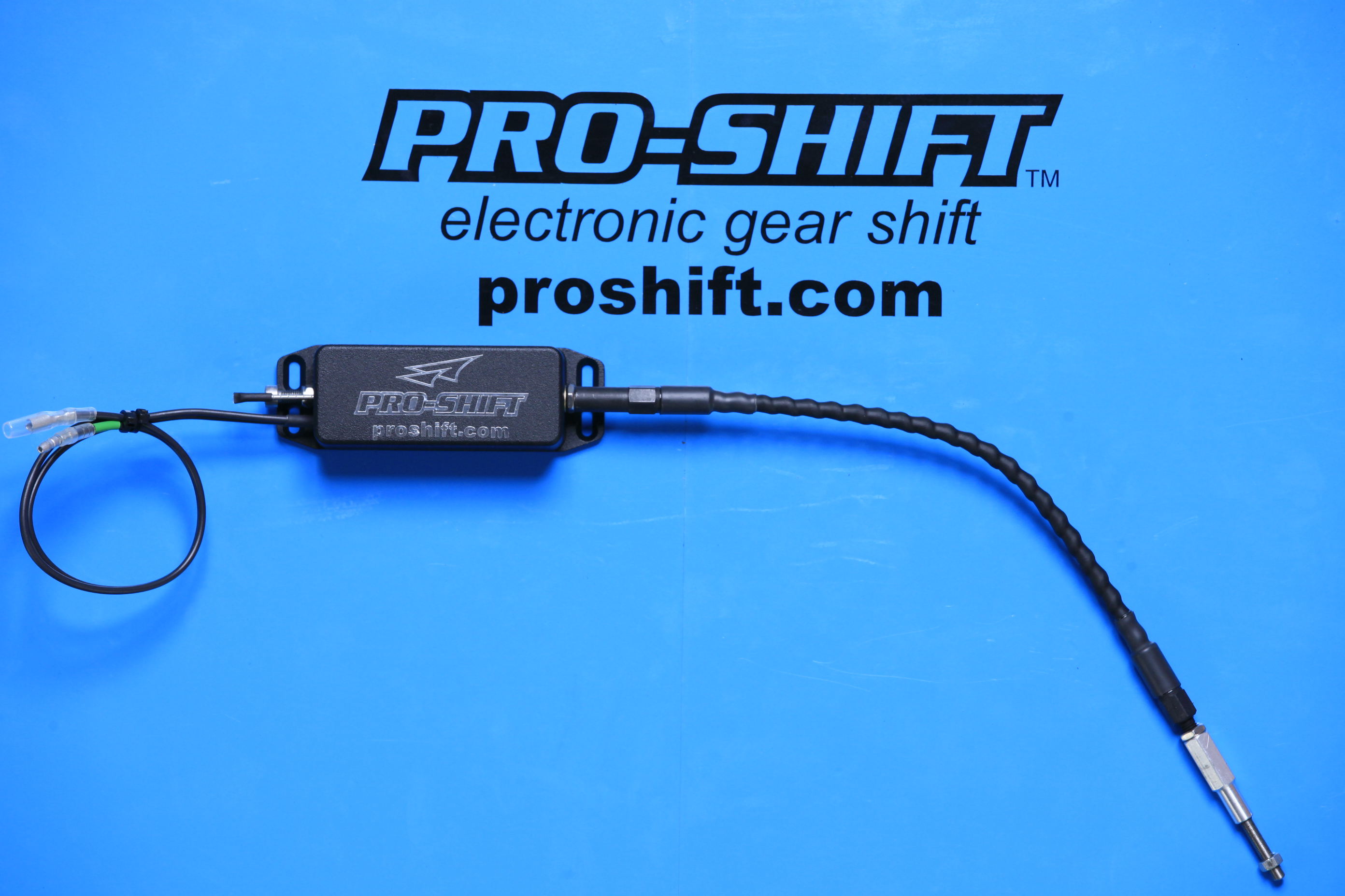

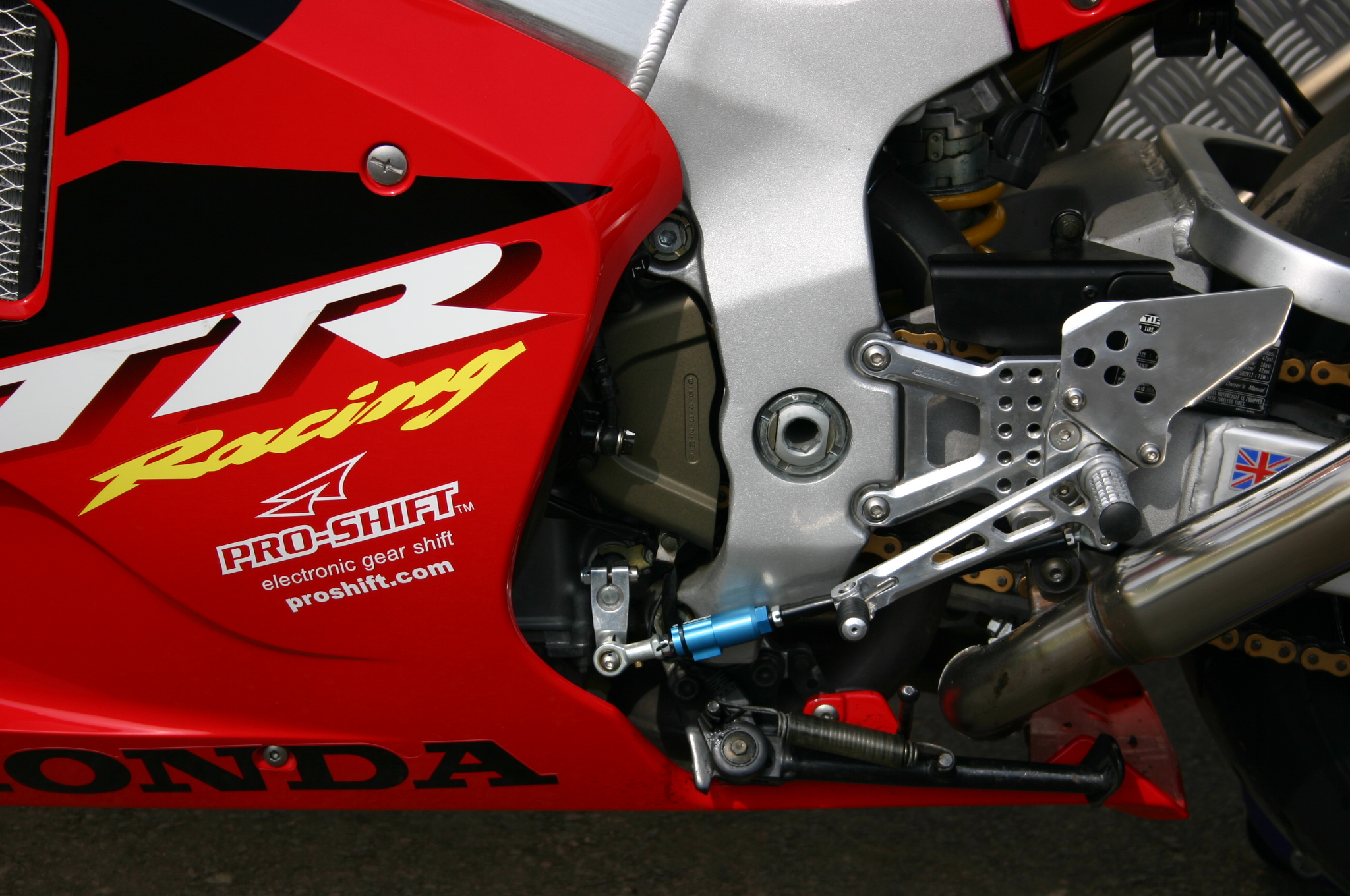

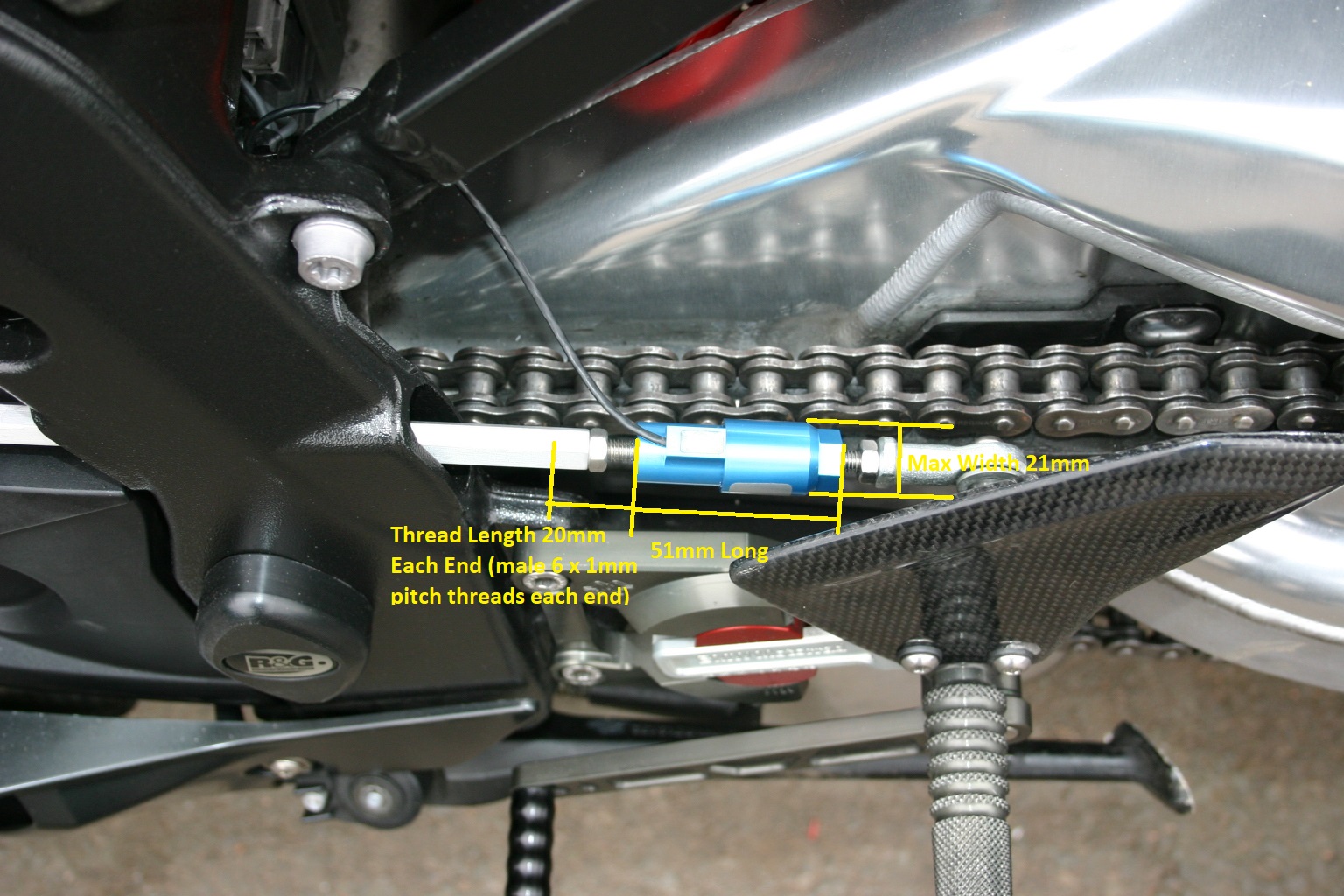

Hello Franz,

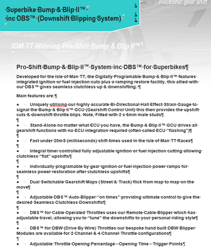

Thanks for your enquiry, we manufacture a high spec combined Quickshifter/Downshift Blipper for your GSXR750 K6 which is our Bump & Blip II System it provides you with seamless clutchless up and downshifts, it is a Completely Stand-Alone System so unaffected by any ECU or Fuelling System that may be installed on the bike.
Gearshift Signalling;

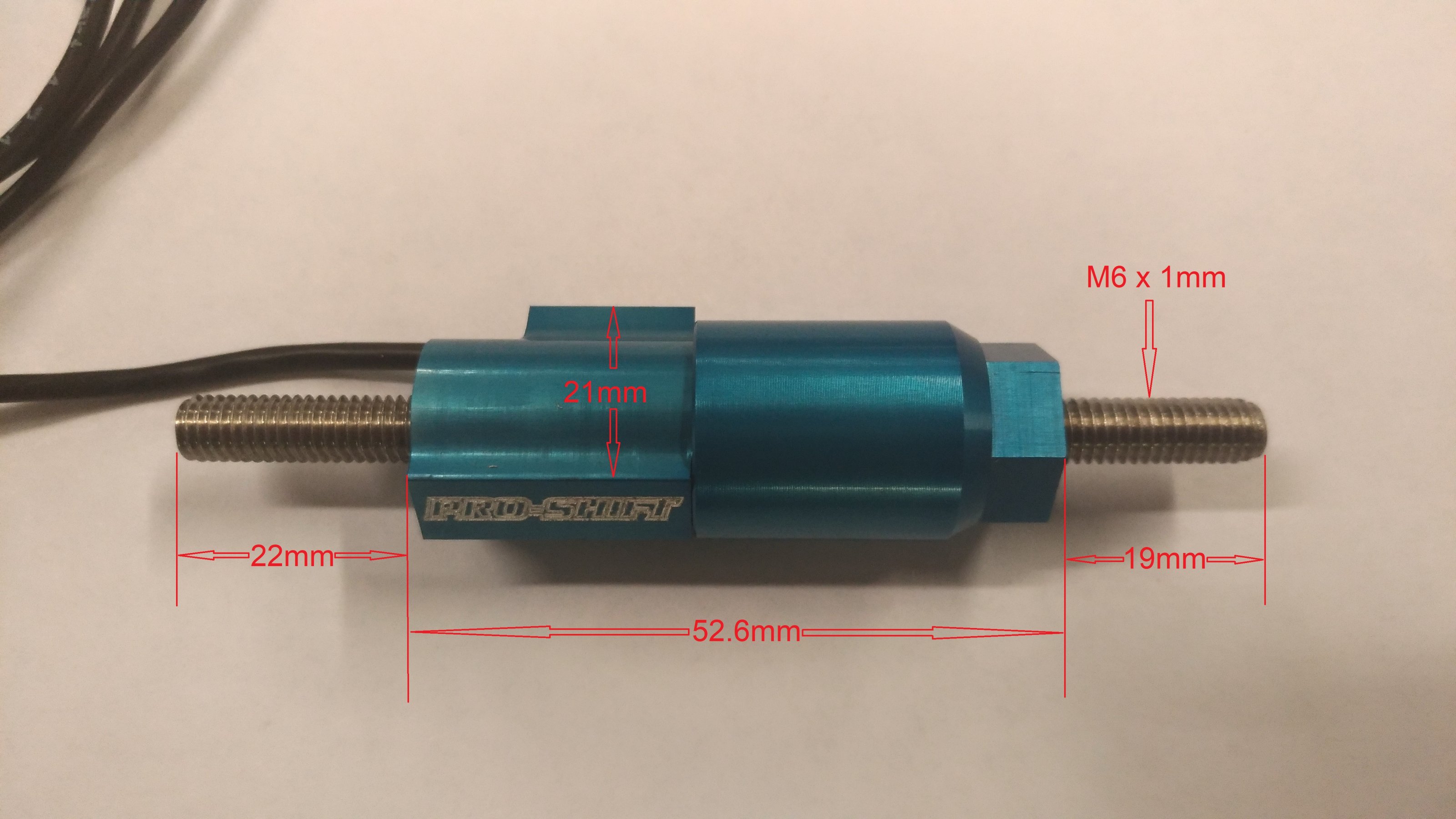

Controlled by our unique 2 Way Hall Effect Strain Gauge, the same method as used in Moto GP’s because it is highly accurate and reliable.
Hand built in house it is entirely different from anything else on the market our hall effect sensor reads through internal magnets and measured electronic resistance this is totally different from commonly fitted “load cell” systems that use simple and cheap mechanical switches which can be prone to failure over time.
See attached a pictures of the 2 Way Hall Effect Strain Gauge which fits inline as part of your gearlinkage.
Upshift Settings;
Factory settings for upshift ignition cuts are set to 45mS (milliseconds) with a post ignition cut 20mS ignition ramp, this is to smooth out power restoration after the upshift ignition cuts.
Downshift Settings;
The GSXR750 has conventional Cable Operated Throttles so to blip them we replace the “Idle Screw” with a threaded ferrule that is in turn joined to a specialist electromechanical Remote Cable Blipper which provides the motive force to open the throttles and give the downshift blips, this method is very effective so much so that it has won both GP’s and IOM TT’s.
The “B&B II” features 2 modes (Street & Sport) so you can run 2 different gearshift maps to suit the riding mood you are in.
All shifting functions are easily adjusted with the remote programming module we provide.
I have also attached a document that explains the Bump & Blip II in a little more detail, please read through it and I’m happy to answer any questions you may have.
Here’s a clip of the Bump & Blip II in action which I think you’ll find interesting…..
Clip / Bump & Blip II testing at Cartagena Spain on YZF R6
Clip / Bump & Blip II Kawasaki 1200 Cable Throttles with Jam-Japan
Further to that please look at the clip below, it demonstrates the Downshift Blipper’s functions very well…..
Clip / Pro-Shift DBS™ (Downshift Blipping System) on WSS Kawasaki ZX6-RR at Misano
The Bump & Blip II inc Remote Cable Blipper IS £1695GBP
Thanks again for your enquiry Franz and I look forward to your reply.
